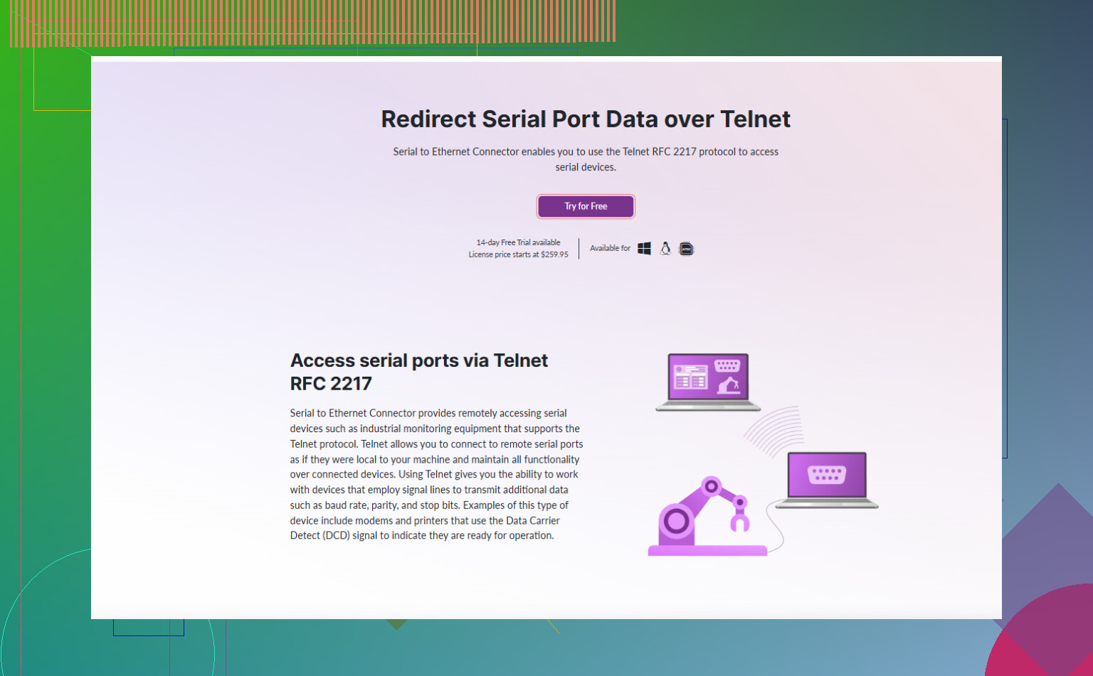

2. GUI / simpler route with a dedicated tool
If you do not feel like wrestling config files and stty, a commercial tool like Serial to Ethernet Connector basically gives you a point and click interface to:
  • Pick your serial port
  • Set baud rate and other options
  • Expose it as a TCP or Telnet server
  • Let remote clients connect without touching low level serial settings
Useful if you have multiple serial devices or Windows hosts and want something stable that you can hand over to non‑CLI folks.

3. Use a full Serial over Ethernet tool when you want less yak‑shaving
This is where I slightly disagree with the “just do it with stock tools” angle. That’s fine if it is one box you control. The second you have multiple devices, mixed OSes, or people on your team who do not live in the terminal, CLI glue starts to be fragile and annoying.
A dedicated tool like Serial to Ethernet Connector makes this way simpler:
  • Pick the local COM/TTY port in a GUI.
  • Set baud rate, parity, stop bits, etc.
  • Expose it as a Telnet or raw TCP server.
  • Let remote users connect from Windows, Linux, or other software without caring about stty voodoo.
If you’re on Windows or you just don’t want to babysit config files, it’s by far the least painful approach. You can grab it from the vendor here:
download Serial to Ethernet Connector for easy serial-to-Telnet sharing
That “software” basically turns any machine into a small serial device server, and in practice it’s a lot more maintainable in labs and production racks than juggling socat and hand-written unit files.

3. GUI route with Serial to Ethernet Connector
If you are on Windows or mixed OS and do not want to explain stty and unit files to every colleague, Serial to Ethernet Connector is an option worth considering alongside the CLI stuff above.
  • GUI driven: pick COM/TTY, specify baud and parity, and expose it as a TCP or Telnet server
  • Works for multiple ports with distinct configs
  • Easy for non-Linux folks to understand and manage
  • Good when you need stable, repeatable mappings on lab machines
  • Not free, unlike socat or ser2net
  • Extra software layer to install and keep updated
  • Less transparent than a plain text config if you prefer “infrastructure as code”
In other words, if you are the only person touching this and you are happy on the command line, what @sognonotturno and @kakeru described plus the systemd variant above is ideal.
If you are setting up a shared lab PC or Windows box and do not want to be “that person everyone pings to fix the serial bridge,” Serial to Ethernet Connector trades money for time and fewer midnight calls.
