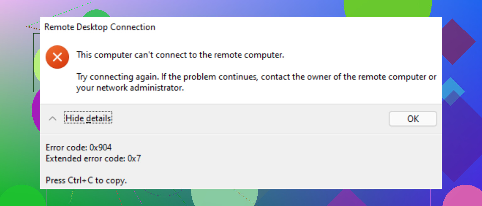

How do I fix RDP error code 0x904 on Windows?
I keep getting RDP error code 0x904 whenever I try to connect to a remote Windows machine over my home network. It was working fine before, and I haven’t changed anything obvious in my settings. Now the connection fails every time with this same 0x904 error. What usually causes this and what are the steps I should follow to troubleshoot and fix it?
This error has tricked me more than once. It looks like a network issue, but every time it was licensing on the RDS side or cached junk on the client.

  1. Press Ctrl + Shift + Esc
  2. Go to the Users tab
  3. Log off any active or disconnected users.
Then try connecting again. I’ve seen 0x904 thrown instead of the nicer “another user is signed in” message when some RDP wrappers were half broken after an update.
I slightly disagree with @ombrasilente here: it is not always just “security layer mismatch.” Single-session limits + broken wrappers can absolutely trigger the same error and look like network / TLS.
3. Check if the RDP port or encryption level got overridden by policy
Sometimes a random security hardening guide gets half applied and forgotten.
On the remote machine run:
  1. gpedit.msc
    Go to:
    Computer Configuration
    Administrative Templates
    Windows Components
    Remote Desktop Services
    Remote Desktop Session Host
    Connections
Look at:
  • “Limit number of connections”
    • If it is Enabled with “1” in there, you can easily hit this and see weird behavior.
  • “Allow users to connect remotely using Remote Desktop Services”
    • Make sure this is Not Configured or Enabled.
Then under:
... RD Session Host → Security
Check:
  • “Set client connection encryption level”
    • If someone forced “High” or “FIPS compliant” and your home client is older or behind some weird router/VPN, that can cause negotiation failures that show as 0x904.
Try setting it to Not Configured (or at most “Client compatible”), run:
gpupdate /force
and then retry.
I’m not a fan of @mikeappsreviewer’s “client registry first every time” approach if there’s any chance a GPO changed. Policies will just re-break it the moment they refresh.
4. Confirm the RDP port and service are what you think
On the remote PC:
  1. Run PowerShell as admin and check the listener:
Get-ItemProperty -Path 'HKLM:\SYSTEM\CurrentControlSet\Control\Terminal Server\WinStations\RDP-Tcp' -Name PortNumber
Make sure the value is 3389 or that you are actually connecting to the custom port you set ages ago and forgot about.
  1. Confirm it is listening:
netstat -ano | findstr 3389
You should see something like:
TCP 0.0.0.0:3389 LISTENING <PID>
If it is not listening, but the service is “Running” in services.msc, I’ve seen two culprits:
  • Some VPN / security software hooks RDP and breaks the listener. Temporarily uninstall (not just disable) any “secure remote / VPN / endpoint protection” tools and test again.
  • Broken upgrade from older Windows build left RDP config corrupt. Toggling RDP off and on in SystemPropertiesRemote.exe sometimes rebuilds things.
5. Check for NIC / network profile weirdness after router or adapter changes
Home setup + “I didn’t change anything” often means Windows changed stuff for you.
On the remote machine:
  1. Settings → Network & Internet → check if your network is Private or Public.
    • If it’s Public, the Remote Desktop firewall rule for Public may be disabled even while Private is allowed.
  2. In Windows Defender Firewall, instead of just “Allow an app,” go into Advanced settings → Inbound Rules:
    • Find Remote Desktop (TCP-In).
    • Double click it → Scope and Advanced tabs:
      • Make sure it’s enabled for the active profile (Private/Public) and not restricted to an old subnet.
I slightly disagree with the “just toggle firewall off to test” advice. On a home machine with random software installed, disabling the firewall can expose it instantly. Better verify the specific rule profiles instead of flipping the global kill switch, unless this is a very short, controlled test.
6. If you are using any router port forwarding or “remote access” feature
Since you said “home network,” if you ever forwarded RDP over the router or used its “remote access” presets:
  • Make sure the router is not doing clever stuff like:
    • UPnP auto rules that changed after a reboot
    • Double NAT if your ISP modem was changed
  • For LAN-only connections, bypass DNS and router tricks:
    • Connect from the client to the remote machine’s actual LAN IP
    • Try both mstsc to that IP and ping it.
    • If ping works but RDP fails and telnet to IP:3389 fails, it is local firewall/RDP service, not router.
7. Last resort: reset RDP config without touching licensing or grace period
If the event logs hint at configuration corruption but not licensing, I’ll sometimes do this on the remote PC:
  1. In Registry Editor (export keys before touching, just in case):
    • Go to
      HKEY_LOCAL_MACHINE\SYSTEM\CurrentControlSet\Control\Terminal Server\WinStations\RDP-Tcp
    • Export that key to a file.
    • Then delete the RDP-Tcp key.
  2. Disable RDP in SystemPropertiesRemote.exe, Apply, then re-enable it.
Windows will recreate the RDP-Tcp entry with default values. This can clear out ancient encryption / bitmap cache / color depth settings that some old RDP-tweaking tools messed with.
I’d do this instead of deleting the GracePeriod key. The grace-period nuking that @mikeappsreviewer mentioned as “lab only” is a really good way to turn one weird error into three new ones.
If you post the exact text from one or two of the RDP-related events in Event Viewer around your 0x904 attempts, it’s usually possible to point at the exact setting rather than randomly carpet-bombing registry keys and policies.

Realistically, if this is one plain Windows Pro machine at home that you remote into, the entire licensing thread from @mikeappsreviewer probably doesn’t apply to you. CALs, grace periods, RD Licensing Manager, all of that only matters when you’ve actually stood up an RDS host with the Session Host role. A normal Pro desktop you connect to for personal use never touches that machinery. So before you go deleting MSLicensing keys or hunting for a license server, ask yourself if you ever installed the RDS role. If the answer is no, skip that whole section.
The advice I’d actually start with is buried down in @ombrasilente and @sonhadordobosque’s replies: read the RdpCoreTS Operational log and confirm the network profile. 0x904 on its own is close to useless as a diagnostic. It’s a generic disconnect code, and the real reason lives in the event text. The Public vs Private profile flip after a router swap is by far the most common ‘it worked yesterday’ cause I’ve seen mentioned for home setups, and it costs you thirty seconds to check.
One correction to the port-check step. telnet is fine, but the client isn’t installed by default on modern Windows anymore, so it’ll just say command not found and confuse people. Use Test-NetConnection remoteIP -Port 3389 in PowerShell instead. Same result, nothing to install, and it tells you plainly whether the port is open.
On the Chrome Remote Desktop suggestion from @stealth_script, it’s a legitimate escape hatch and I wouldn’t dismiss it. Just know it isn’t really RDP, so it won’t help you diagnose the actual failure, and it leans on Chrome staying open, a Google account, and the machine not sleeping. Good for getting in today while the real box is broken, not a fix. If you want people here to point at the exact setting instead of guessing, paste the event text from one failed attempt. That single detail usually ends these threads faster than any checklist.
