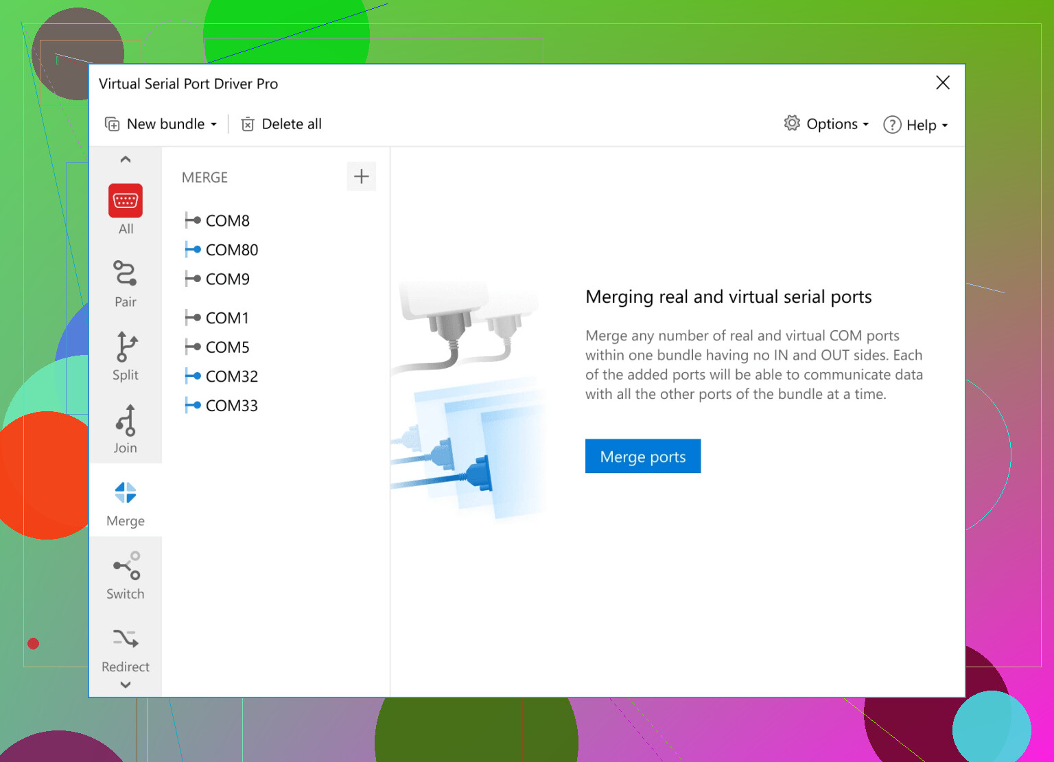

Create a virtual null-modem pair using Virtual Serial Port Driver as your COM port emulator. Point the program under test at one port and open the other from your local responder program. Bytes written to either end arrive at the other, so you get two-way communication rather than an output file. (virtual-serial-port.org) Start your responder with a simple “read command, send expected reply” loop, matching the device’s message format. Then add deliberate delays and invalid replies to test how your application handles failures.
If your program expects hardware handshaking, check that before writing the responder. I’d keep the paired-port approach, but Virtual Serial Port Driver’s custom pinout support is a real plus here: the app lets you configure the virtual control-line connections rather than relying on the default wiring. (virtual-serial-port.org) Get that setup matched to your device before debugging the command replies.
