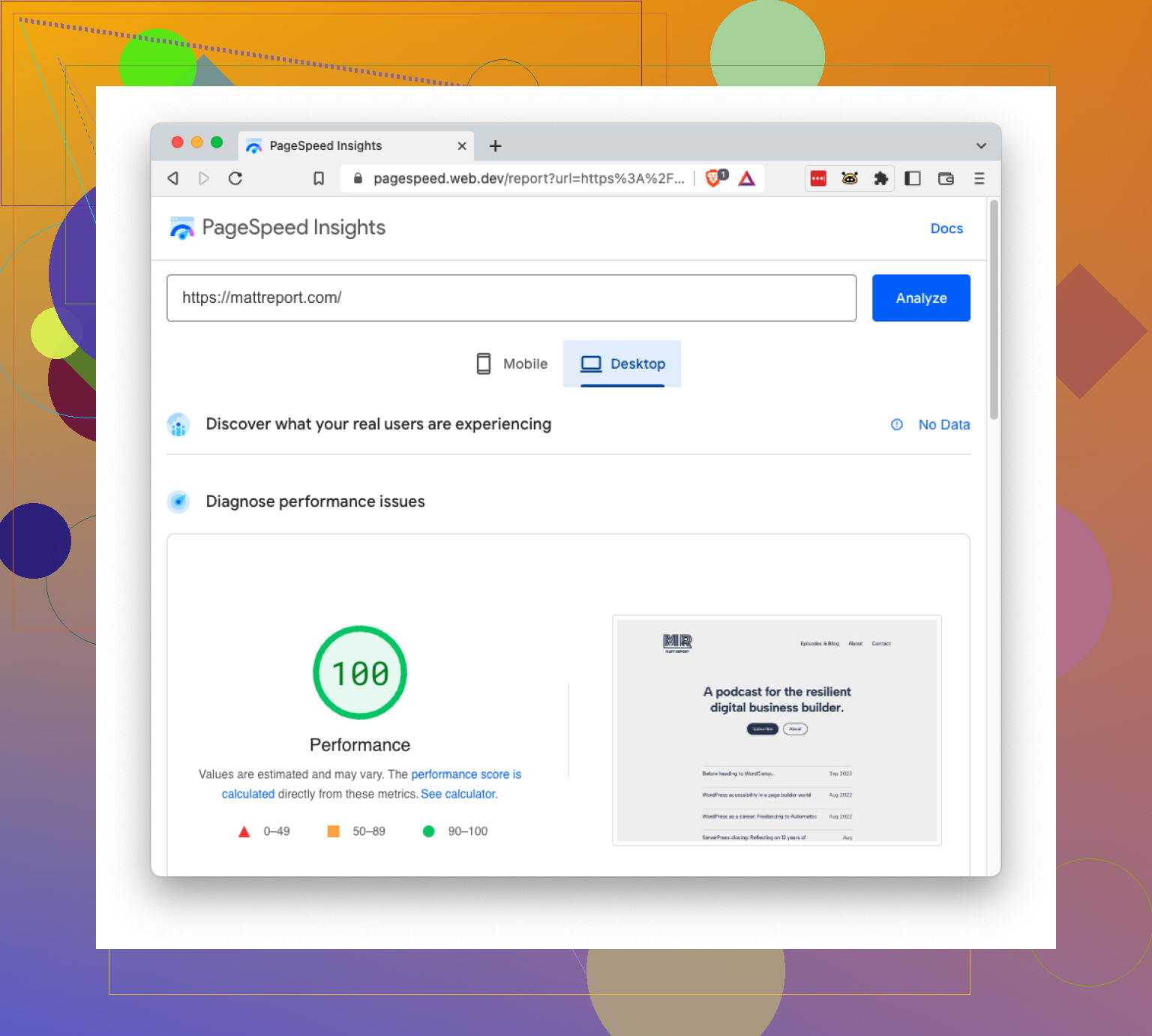

Speed
What hit me first wasn’t some homepage score screenshot. It was the backend. The admin area felt quicker right away. Opening the post editor, hopping between settings pages, moving through routine tasks, all of it felt tighter. If you spend hours a week inside wp-admin, you notice this stuff fast.
I expected decent performance because I was spending around three times more than I used to spend running sites on my own servers. So yeah, speed needed to be there. The part I didn’t expect was the relief. Years ago I did server admin work, around 20 years back, but I’m rusty now and I don’t miss babysitting boxes. Handing that off took work off my plate in a way I felt on day one.

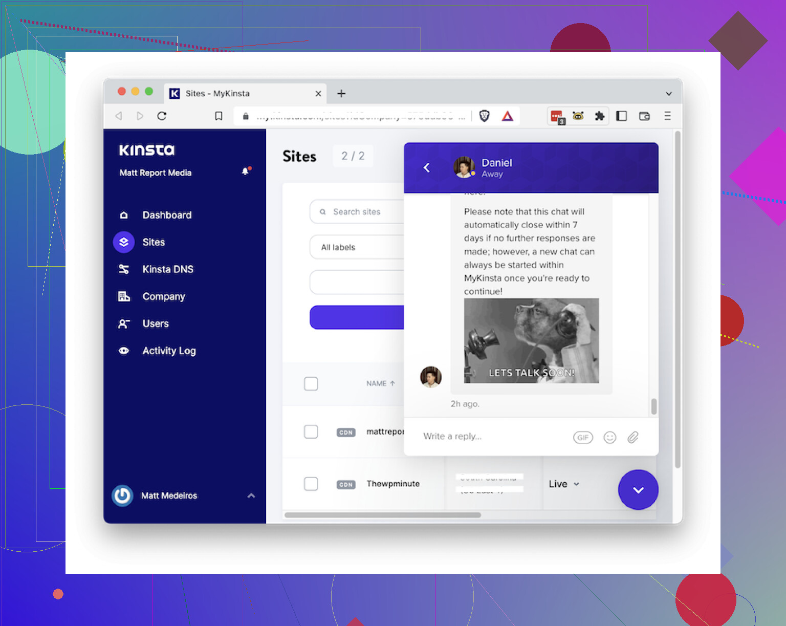

Control Panel
Small confession. At the hosting company where I worked before, we lost deals to Kinsta a lot. I knew why. We had some of the same functions on paper, but users had to jump through weird technical steps to reach them. Most people don’t want a scavenger hunt. They want buttons, clear labels, and a panel where common jobs take a minute instead of a doc search.
The parts I keep using are these:
  1. Staging and backups, this is the cleanest setup I’ve used. It saves time and cuts down on dumb mistakes.
  2. DNS management, easy to find, easy to edit, no drama.
  3. Traffic graphs and reporting, useful for checking activity and keeping an eye on monthly limits before you get surprised.

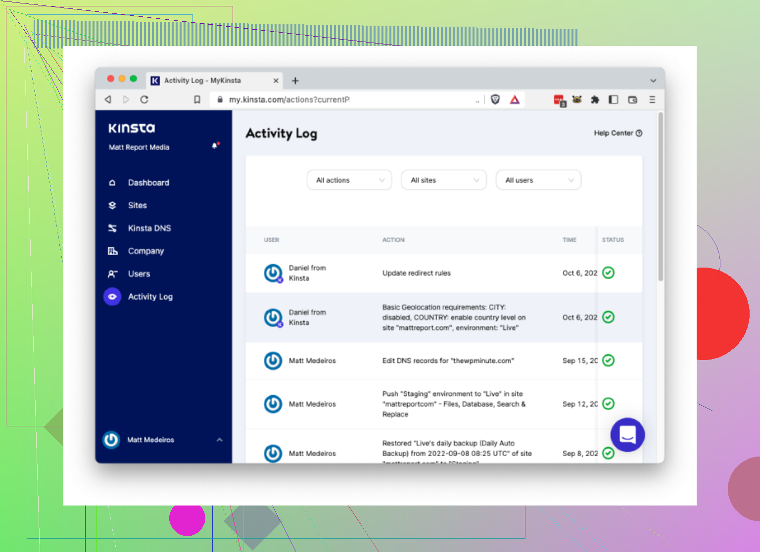

  4. Activity log, this one matters more than people think. I can see what changed, who changed it, and even when support touched something.
It doesn’t try to copy cPanel and stuff every possible switch into one screen. I like thta. Fewer dead-end options, less clutter, less time wasted.
