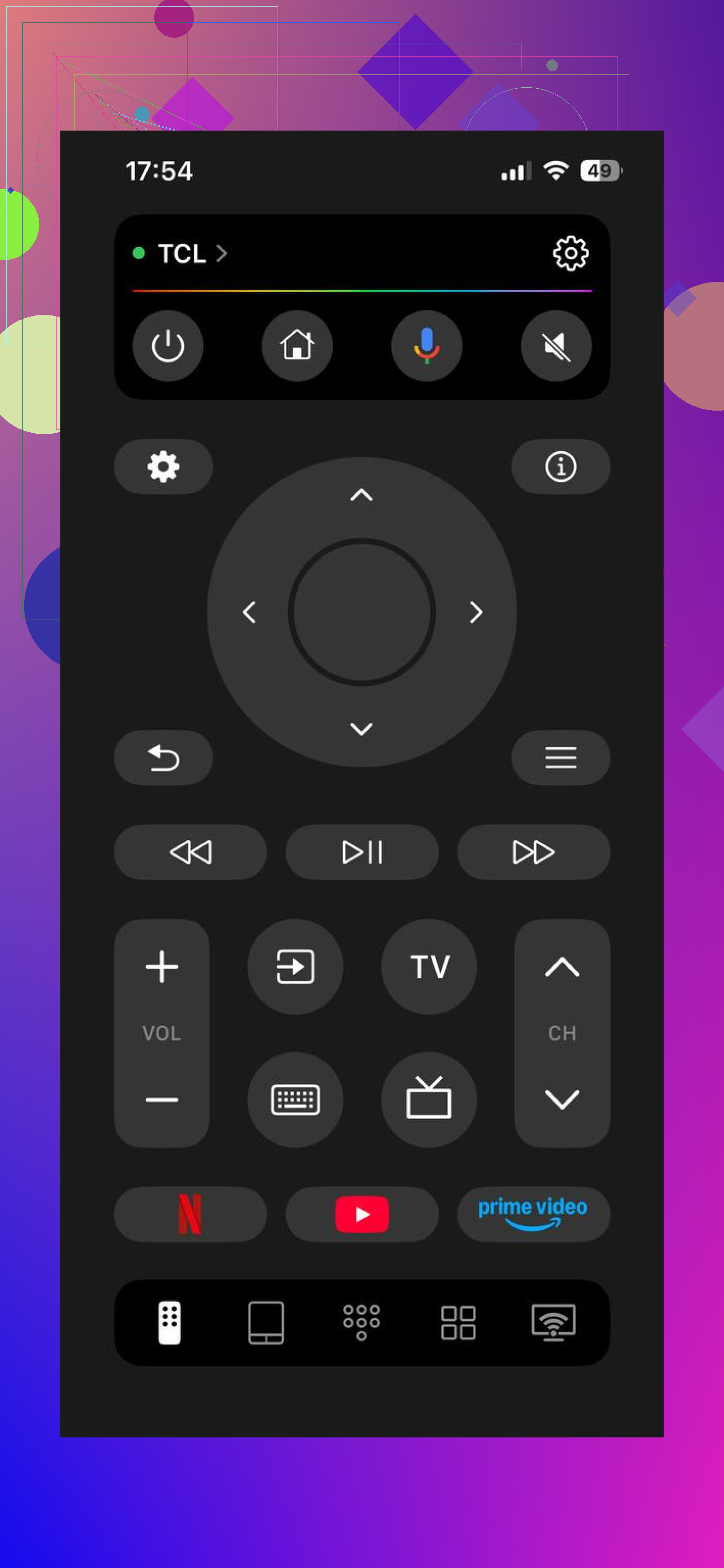

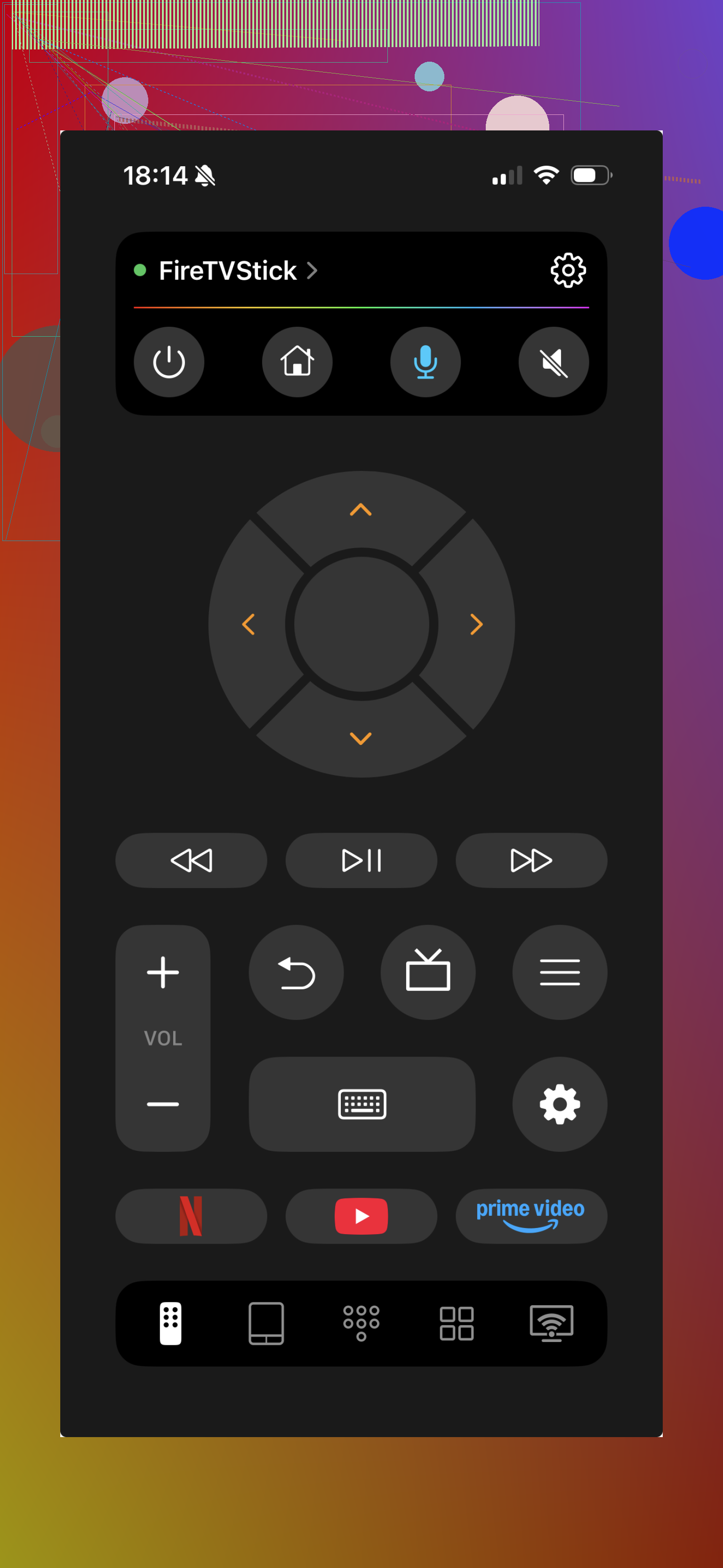

I use it with Fire Stick and TCL TVs. Here are the screenshots:
It’s free with no subscription and includes useful controls like a touchpad, keyboard input, and one-tap app launching. There’s more information about it here: Free TV Remote App for iPhone & iPad: One Remote for Almost All TVs
